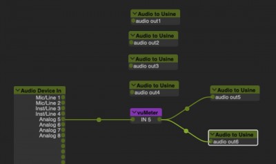

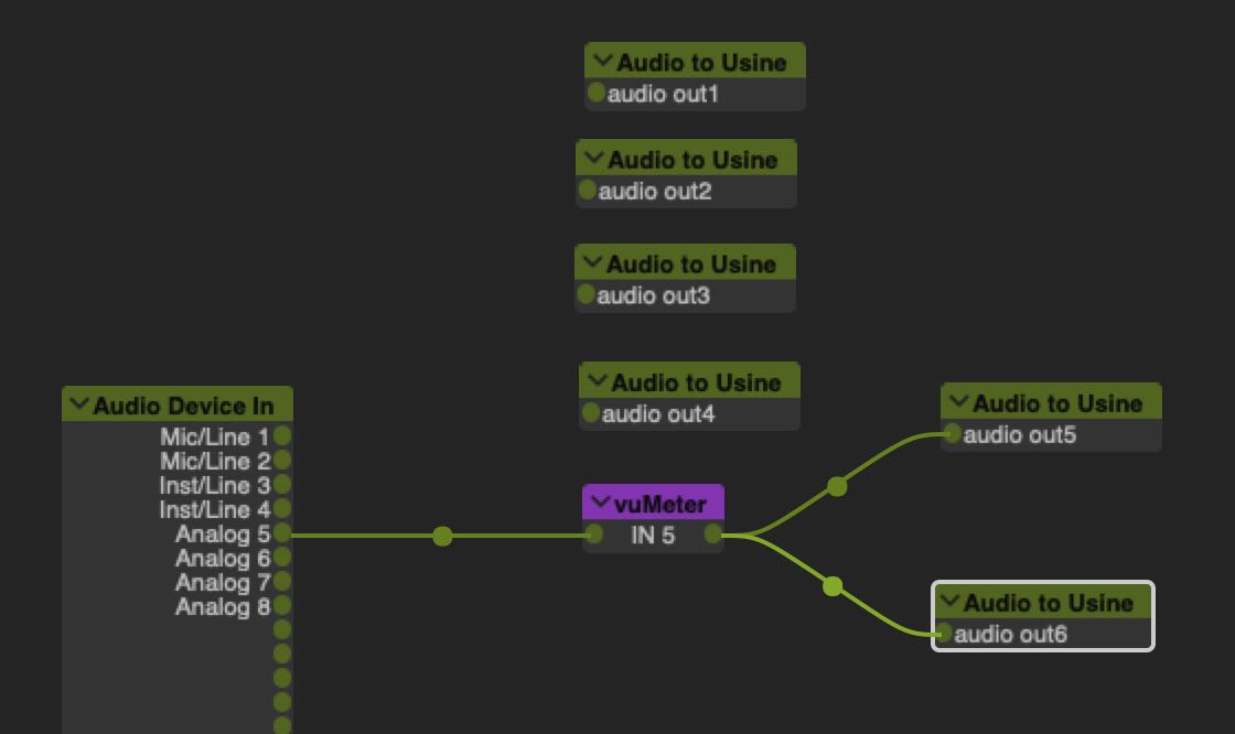

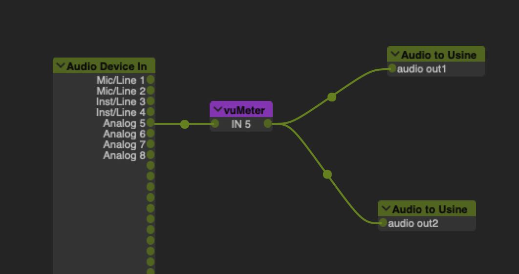

Since a long time when i create a new Audio Device Input for the INPUT 5 of my soundcard, i path it like that :
Recently, a friend told me it is not the right way to patch it, and he told to me to patch it like that :

In the first case, your audio device send 2 mono signals to its 1 and 2 output. It's the simplest way to use your signal in a rack, with stereo plugins and stereo patches.
In the second example, you send 6 channels, but the signal is only on 5 and 6. It's only useful if you work with surround (and if you need to get the signal on 5 and 6)

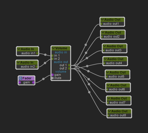

In Usine, you choose your in and out numbers from top to Bottom.
for example, I usualy split my stereo to surround like that : the volume module is stereo, but the left output goes to 1, 3, 5 and 7 and the right output signal is send to 2, 4, 6 and 8

It is for convenience and patch organisation.
Everything is handled from top to bottom, audio in and out, data, string, array .....
