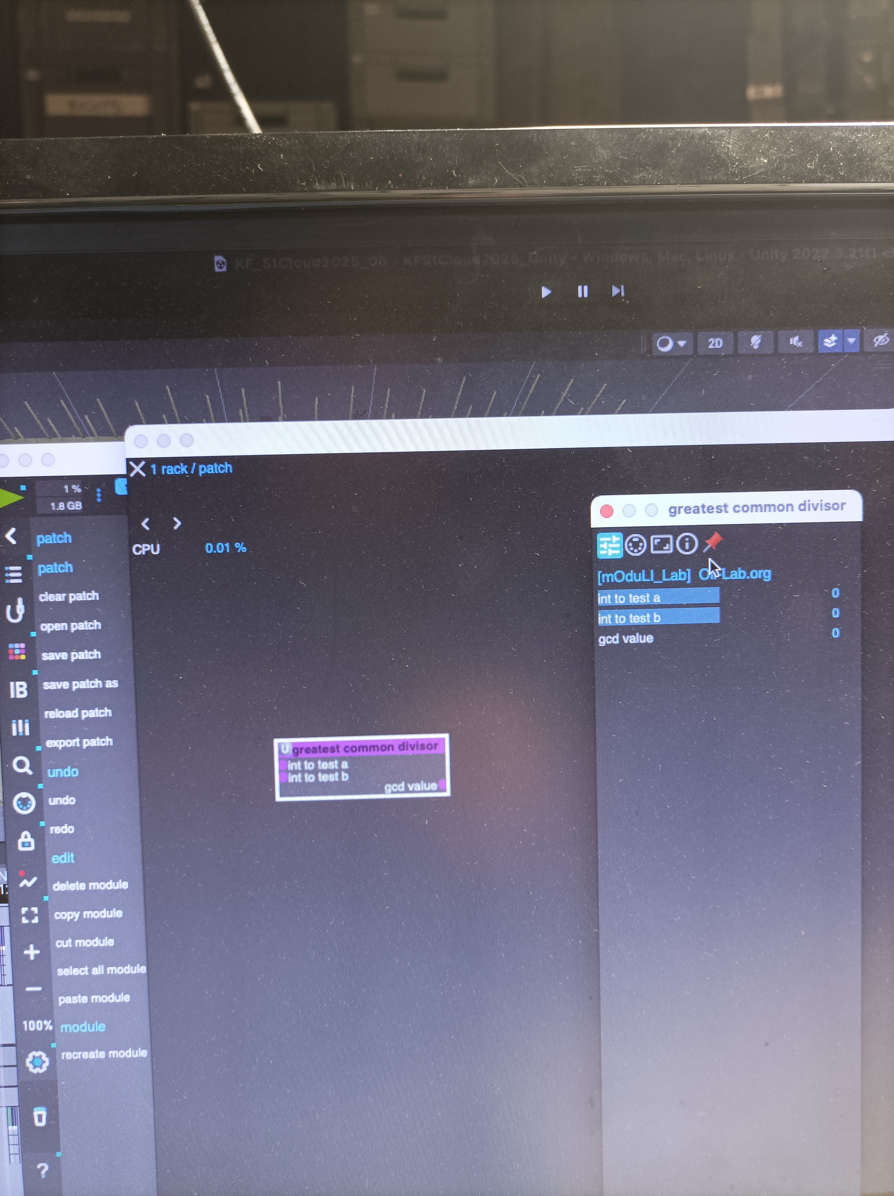

Unread post by oli_lab » 08 Nov 2025, 10:46
if someone can load the GCD module (datalab/math) into a M4 and tellsme if it is loading alrigth, that would be great !
thanx
Posts: 466
Location: 22110 Rostrenen
Unread post by grego mondo » 09 Nov 2025, 00:52
Load all right

can you try to load the GCD module (datalab/math) into a M4 and tell me if it is loading ok ?
I'm puzzled !
find out so far that M4 need ARM64e and M2 only ARM64
thanx
Unread post by cmodica » 16 Nov 2025, 18:36
Hi and thank you for your job !
Sorry for the late reply.
I tested on a Mac M4
can you try ADDSRV3 and phaseDistortionV3 from modulilab34 ?
ADDSRV3 and PhaseDistorsionV3 not loaded (Invalid)
load ok ! 8)
