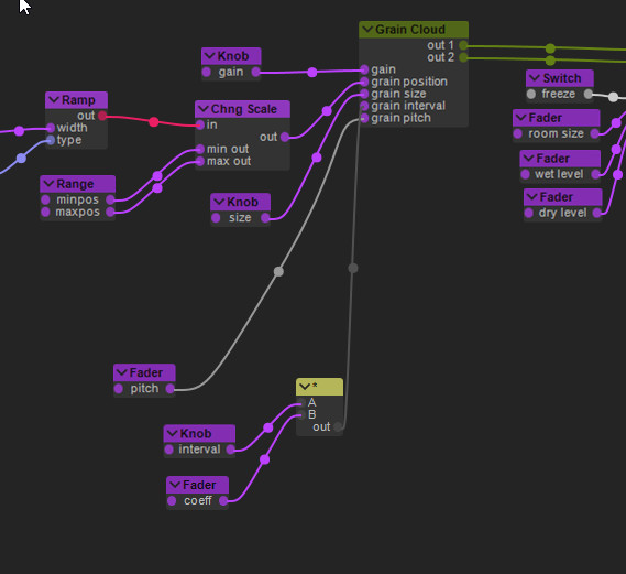

I would like to apply a multiplier coefficient to the Interval parameter of the Grain mangler. When I insert the math x or math / module, I don't know where to connect the start value and I don't know where to write the value of the coefficient.
This is a basic patching issue, but I am not familiar with the modular. My apologies if the explanation already exists somewhere (so I want it). Thanks a lot for your help!
Unread post by senso » 05 Jul 2022, 08:52
I don't really understand the question.
something like that ?

Unread post by gwennaelle » 07 Jul 2022, 12:20
Thanks Olivier !
To contextualise my research, I want to play different types of players and I want them to be synchronous.
I'm looking for the correspondence between the intervals (ms) (in a player with a clock for playback, and in the grain mangler), the speed (in the 34-Physics2 in this case) and the Synchro Quantize Trigger sync (of delays or sequences). Hence my initial question.
I'm going step by step, my research is empirical. There is probably a global logic, on the ms-quantization relation, and on the global control of the speed of these modules.
If you have any ideas, thank you!
