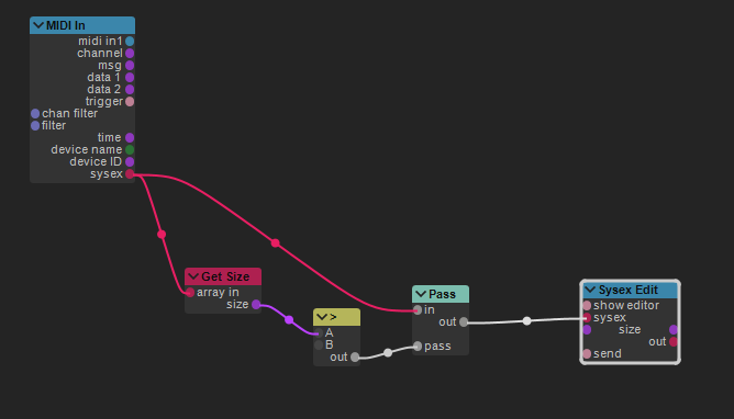

I did some test with my Blofeld,
I reckon there is a problem with the sysex output on the midi input module :
when sending dump from the synth, I receive an empty array [0] then the dump [390], then another empty array [0]
so the sysex editor store only the last empty array !
here is a workaround :

Thank you very much, that's a good advice!
