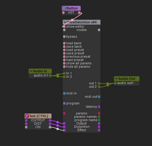

Hi all. I'm working on a project that has several racks, each rack has four patches that contain one VST plugin on each. I'm not sure how these patches transmit audio signal among them. In theory a rack is what it is in real life, it is suposed to flow the audio signal among all patches in SERIES until it reaches the output stage of the rack. In theory it is also necessary to add AUDIO IN and AUDIO OUT modules to each VST to get this flow done. The thing is that each patch will be placed within the rack using the LOAD PATCH functionality of USINE according to each case, the project is a sort of guitar effects processor where you can select different components (effects) as need it.
I build each patch separately, so each one has AUDIO IN and AUDIO OUT modules, the problem is that when two or more patches are placed in a rack (in series) they all will pick the same audio signal from the INPUT stage of the rack acting more as a PARALLEL system. I hope I'm explaining myself propperly and that you get the idea. I need the audio signal flow to be IN SERIES.

Hi joffo78, thanks for replying. Attached are images of how the each patch and the rack are built. I understand that each VST has to have AUDIO IN and AUDIO OUT modules to transmit audio. Every patch has a different audio VST and every VST has the same AUDIO IN and AUDIO OUT modules as seen in the image. These patches have to be interchangeable within the rack orderwise. If I put two or more patches in a rack each patch will receive the same audio signal from the audio INPUT source from the top of the rack (audio 1 device). In this case they will be in parallel and not in serie. I wonder on how to build the patches in order to achieve the desired IN SERIE configuration no matter on the order of the patches.
- Posts: 487
It's made as in a real rack
Audio from above goes in the audio in
and the audio out goes to the patch below
where
in your picture audio goes in the MXR DIST and then in the KLON

- Posts: 494
Did you check your rack settings ?
By default, a rack is calculated in serie. But there is an option to use them in parallel. Maybe you selected parallel and forgot it.
Otherwise, I don't know, it seems you did it correctly.
Can you share you're project ?
