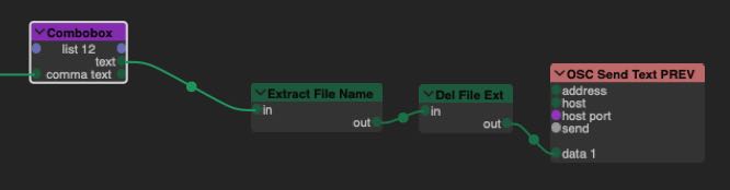

But I would like only the title to be displayed.
For the moment I get the path, title and extension of the file via the Text output of the Combobox or Listbox.
How can I hide the path and file extension, as it is done via the "Short file name" option in the sampler?

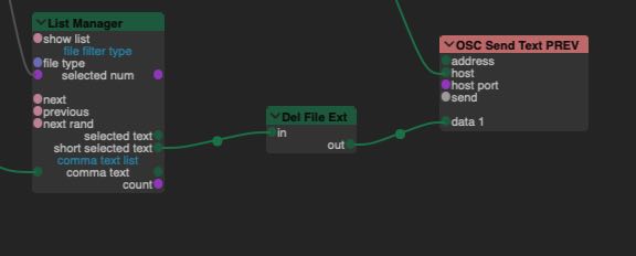

I found the solution.
I use a "Flie List Manager" and a "File Delete Extension" modules instead of a Combobox or ListBox. Witht the "File List Manager" there is the possibility to connect the "Short File Name" output.
But there is an other way to patch it with a Combobox or Listbox. It need to patch the text output to "File extract Name" module and a "File Delete Extension" modules.

Great. Remember you have an option in the combobox or list box to hide the path and extension. No patching needed.
Yes it is right. This option hide the path and the extension in HH but there are not hide when i patch the Text Output in the OSC data 1.
It is like there are hide in HH but not via the Text output of the module.
yes it's only a display option and it doesn't affect the output.
to modify the output use filename-extract-name and filename-extract-extension modules.
Yes. That is what i have done.
