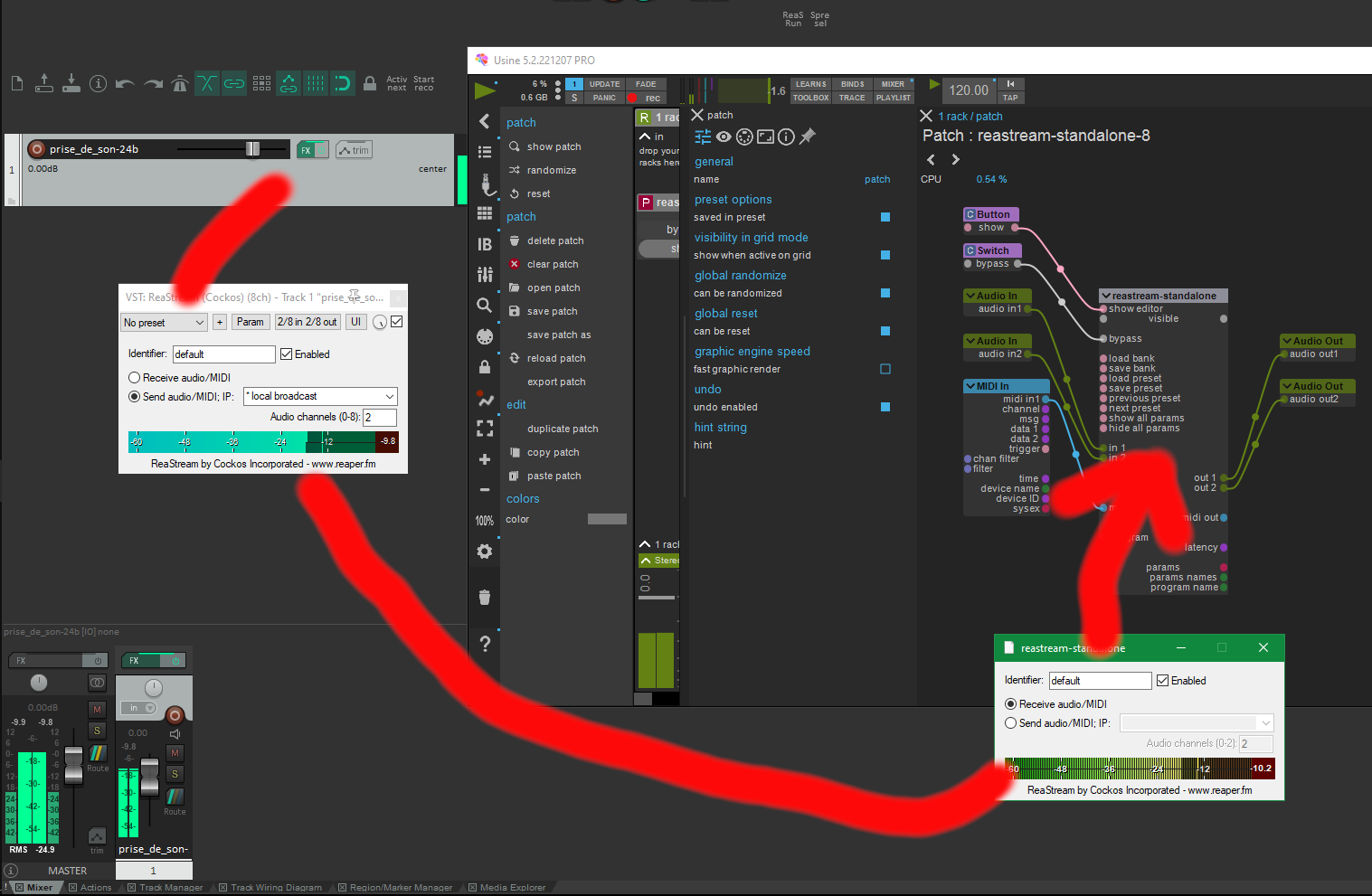

Reastream is the answer ! for midi and audio.
works back and forth between your DAW and Usine, thru LAN (on 2 different computers) or internal (127.0.0.1)
up to 32 tracks.
ReaStream
Supports streaming from host to host of audio and/or MIDI over a LAN segment
Supports streaming from different host software on each end
Supports UDP broadcast for streaming one to many (if local network can keep up)
https://www.reaper.fm/reaplugs/
