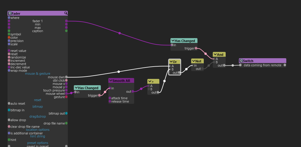

When moving e.g. a fader with the mouse we can use the mouse down output to know it the fader is activated by an external gesture.
But if there is a remote on this fader (Midi controller) it seems there is no way to get such information.
That's why I was asking for a "remote output", sending trigger when activated.

an "has changed" module on the fader output would do the trick ? except if you want to dissociate data coming from the remote and data coming from the mouse, in that case :
attack is 0ms and release is 200ms

But what I need is to get the info if a remote (OSC, MIDI...) is controlling the fader (or another object) . If I'm not mistaken the "has changed" module
would send datas also if there were a recorded automation or some modulation sent to the fader.
