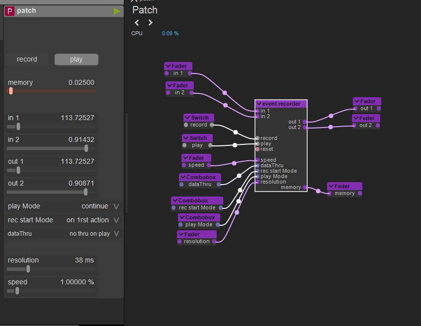

- Posts: 1325
I did some heavy patching and finally I made a new module : it was easier with C++ !
will be soon included into the Oli_Lab pack
can record incoming floats of any size, replay at any speed.
Up to 64 inputs/outputs and 5000 events.
perfect to record incoming OSC messages for example.
