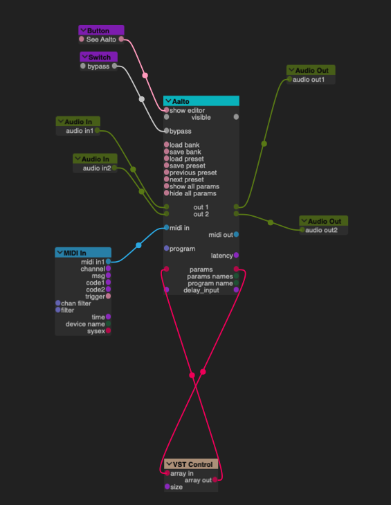

yeap . solution is to untick "Save in Preset" on VST module and it should work fine . also there is a quick solution to avoid assigning parameters to knobs on VSTDAD .you can use array and just control everything from your chosen VST that way if you have lots of parameters on your VST you will save time to map every single parameter to VSTDAD and above else you gonna have to change VSTDAD as it has only 8 knobs doing which is a bit of patching as well . if you untick
Usine is great deserves much more popularity if you as me
GenCode
Posts: 34
Unread post by GenCode » 15 May 2022, 22:45
actually i've just tested . it works without VSTDAD just fine . jus untick "Save in Preset" on VST module and no VSTDAD is needed . but plugin window jumping around , can't maintain its position . with array it stays in place .
Posts: 555
Unread post by sm_jamieson » 16 May 2022, 10:31
Can you explain where / how you connect the Array module to achieve storing of parameters and keep the VST window in place ?
Thanks,
Simon.

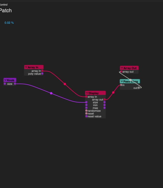

GenCode
Posts: 34
Unread post by GenCode » 02 Jun 2022, 01:21
sorry for late reply was buisy with other things . here see on pictures just connect it like so and it should be ok . see sub-patch picture as well
