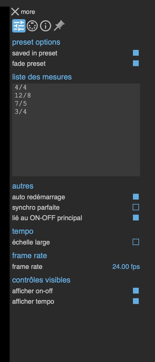

Hi. I tried to find this but didn't see anything so, my apologies if this has been covered. The bar list in HH6 is reverting to 2 bars of 4/4 every time I press spacebar. The only workaround was to have a Synchro module with a Comma Text forcing the bar list that I wanted. Has anyone else experienced this? Is there something else that can be done or do I just have to have it that way always?
Unread post by cmodica » 24 Nov 2025, 10:57
Right clik on the tempo open a window with some tempo setup.
Here you can write the bar list you want for your project.
This list is save with the project.
