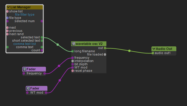

I've loaded wavetables as wave files but when I change the frequency I've got strange results: non linear response, inconsistent, and not following the frequency curve.
As the recording attached. What am I missing?
- Posts: 1325
try the module from Oli_lab, it is more compliant with different wavetables ans has a interpolation option for smooth transitions between waves !
- Posts: 289
It works fine with this module. Thank you!

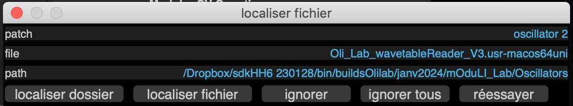

I'm trying to test “wavetable reader V3.wkp”, but I can't get it to load properly.
I have updated HH to the latest version and I have also updated modulilab and oliloscope addons.
Some files seem to be on a Dropbox and I don't know where to redirect HH to find them ...
I am attaching a screenshot of one of the missing files, there are several.
Thanks for the help.
See you soon.
PS: I'm on MAC Intel OS 10.14.6
See you soon.
- Posts: 1325
ho sorry for that !
the wavetables are located in the modulilab/oscillators folder within the addons.

But where is the addons folder on mac os ?

- Posts: 1325
Not very fluent with MACOS, only fire the mac mini to compile the user modules !
As I understand, all the things Usine are in the Usine folder in the app folder.
You may do a search for "wavetables" as its the name of the folder I put them in.
Tell us when it's OK

Hi and thank you.
It works.
The Addons folder and all the files needed on Mac OS X are in the Usine folder/contents/Config/Addons/
Thank you for this great wavetables synth. Great job !!
It works.
