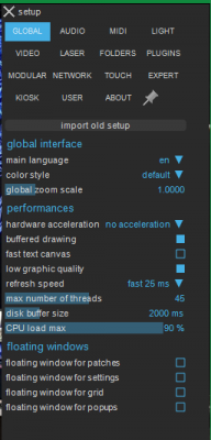

- Posts: 1301
hope this help
hope this help

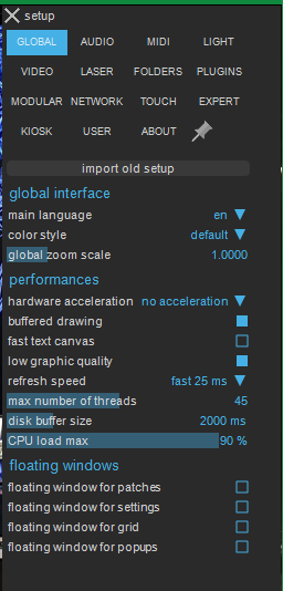

unguitar
- Posts: 126
thank you very much Oli,
the settings you're showing are the same I have. I just had to switch hardware acceleration off.
However 5.xx is still not working, it shows consistent dropouts and glitches.
Will do a fresh reinstall later today.
If it doesn't work I will get back to 4.xx and accept some plugins won't work.
In the meantime I will look to alternatives to Usine, it's just happening in a very inappropriate time, with many works going on and no time to waste.
btw, your settings page looks different than the one on 5.xx, are you still on 4.xx?

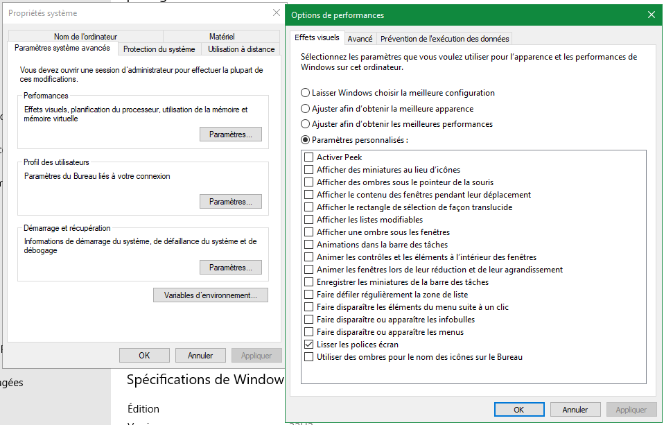

- Posts: 1301
Other thing to check if you're usine osc :
Make the osc faster in the settings as usine can go beserk when receiving fat osc.
There is also something to do in the registry to set the priority to your sound card. IRQpriority
https://www.brainmodular.com/forums/vie ... ity#p41836
Excuse my French;-)
Excuse my French;-)
