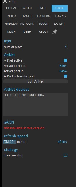

Hello. As stated before, non of the DMX configuration parameters appear in setup light tab as shown in Gisolrnette attached pdf. Instead this is what I have:
I'm using an uDMX 512 interface, driver is installed and the device is being recognized and working by both FREESTYLER and QLC Lighting softwares. Also I'm getting the following error message when HH starts:
create procedure failed in: device DMX

Thanks Joffo78 for replying. Yes, i've tested many times and the error message appears even with no interface connected every time HH starts. I downloaded a fresh copy of HH to discard any bug and the erroris still there. Too bad and sad, I do have some light fixtures that want to put in use. As said bebore, it is working fine with FREESTYLER software but I would prefer to inplement lighting only wyth HH, I don't want to deal with two softwares.

thaks Senso for your reply. I don't know why FTDI drivers could be corrupted. I do not have an ArtNet device. The issue is shown in two defferent computers with WI 10 and WIN 11 Os respectively and the eerror message appears in both of them:
I'll try reinstalling FTDI drivers and let you know thw results.
I reinstalled FTDI drivers and the problem persists. I doubt it is an USB driver related issue since it is presen in two computers and the error message is displayed in both of them. Non of the DMX interface setup parameters are shown in any of the PC computers.
