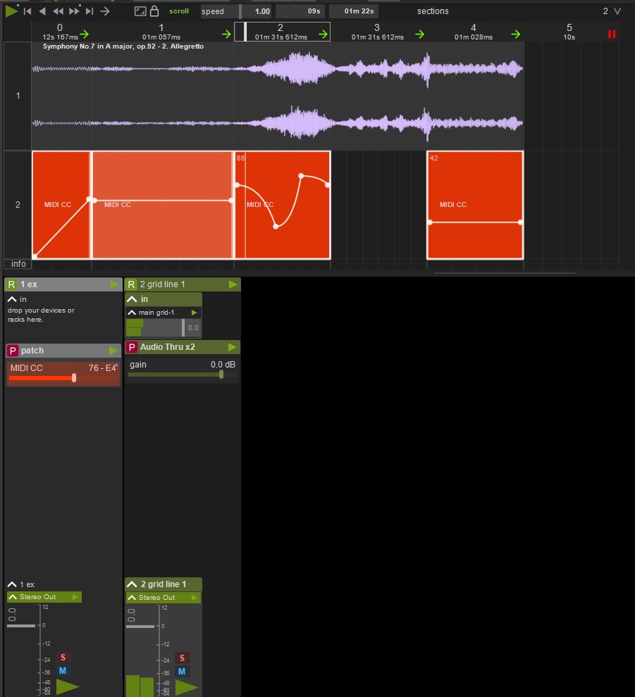

I need to create a project with just a long audio file around 60 minutes on one track and a second track consisting of just an automation curve sending control change . The idea is to be able for example to set at 2m30 a 63 CC value and so on .

you should create a new section for each event. Put your 60min sound on the first line and then, create different section managing your CC values.
like that :

Thnaks for your answer ! i can see a bit more how i can set this up then . The CC value patch used in the example, Which module did you use ? I did a little example and i couldn't find how to make the CC value fader from the patch visible in the grid section ??

Unread post by rlgsbt » 08 Nov 2022, 07:50
in this exemple, it's just a simple fader in the rack n1. You can use anything in the grid with ctrl+shift.

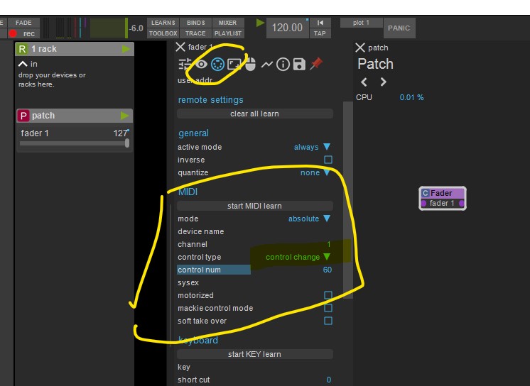

Thanks :) Can you make a screen shot of your CC change patch ?! ican't make mine working !!! Sorry but i didn't use Hollyhock for such a long time !

Unread post by rlgsbt » 09 Nov 2022, 07:25
it's a simple fader with midi learn. In the midi section, chose your control type (CC) and the CC number. that's it
