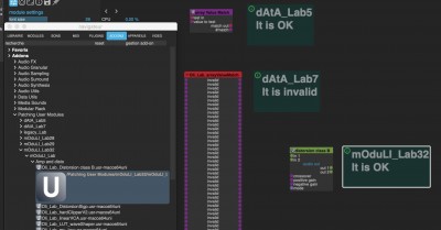

2025-07-07T18:39:48+01:00 2025-07-07T18:39:48+01:00 https://brainmodular.org/forums/viewtopic.php?t=7380&p=45938#p45938 <![CDATA[Re: Event Recorder V2 !]]> datalab7.jpg

2025-07-05T16:57:03+01:00 2025-07-05T16:57:03+01:00 https://brainmodular.org/forums/viewtopic.php?t=7380&p=45933#p45933 <![CDATA[Re: Event Recorder V2 !]]>
It seems that on MAC OS X, Apple intel, none of the modules work.
The modules in the data_Lab 5 are working fine, but the modules in the data_Lab 7 (i suppose the last one) are all invalid.
And so, the "event recorder V2 exemple.wkp" doesn't work.
Have a nice day.

2025-07-07T21:20:44+01:00 2025-07-07T21:20:44+01:00 https://brainmodular.org/forums/viewtopic.php?t=7380&p=45940#p45940 <![CDATA[Re: Event Recorder V2 !]]> I reloaded the data lab, it is now data_lab8, tell me if it is OK
